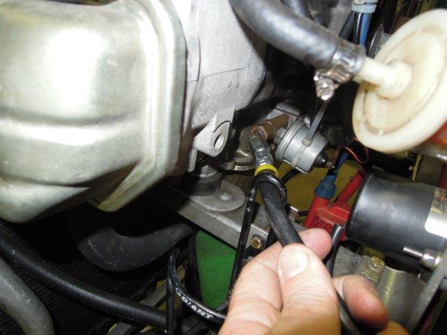

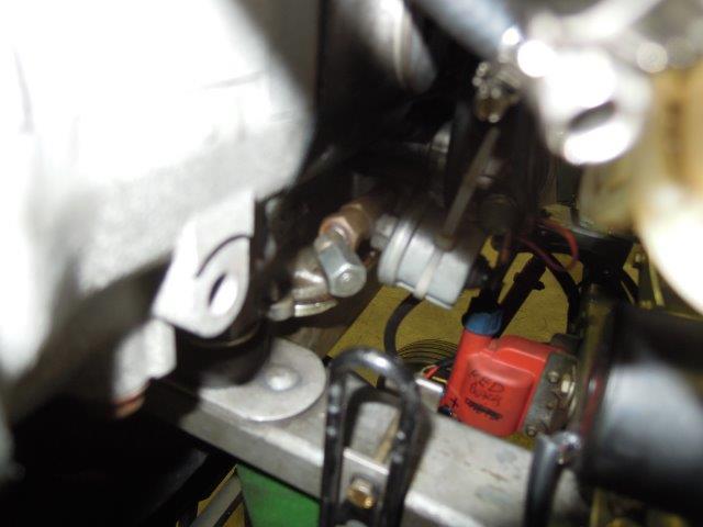

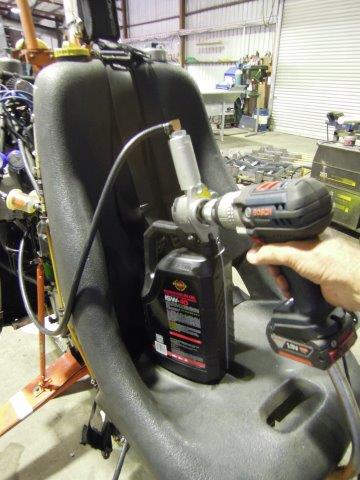

when I was doing the oil change I used my drill powered oil pump into the engine oil gallery I had posted about in forum version 2 . any way because eit was very top heavy, I made an aluminium base and holder frame, well that went well , and also machined an adaptor to hold the oil pump firmly into the top of the 5lt oil bottle. 1 slight change needed is 1 of the vertical frame that holds the top support ring, has covered up the clear window on the oil bottle . being able to see the clear window on the oil bottle when pumping the oil in is great as you can visually see the level of oil that has been pumped in.
the pumping oil into the engine via the oil filter and then through the oil galleries is one of the best things , my engine, on start up after an oil and filter change seemed to rattle and tick away endlessly until the oil pressure built up , pumping it in through the hydraulic fitting and then capping it before starting give instant oil pressure. I love it.
