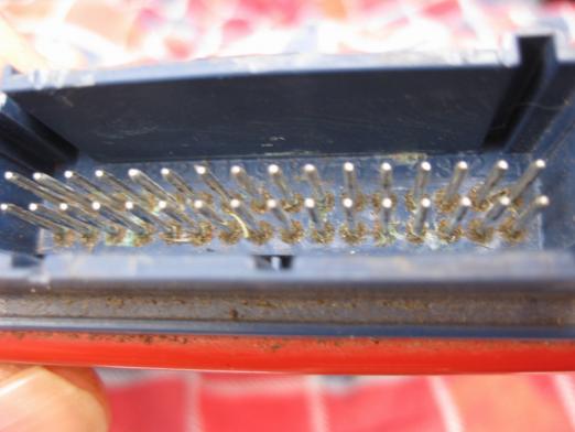

          I was involved with a Gyroz fault which caused the Hirth engine to return to an uncommanded idle during flight. It turned out that the factory had installed the engine electronic management module upside down. This placed the plug upwards and when it rained the moisture would collect around the terminals causing corrosion which caused the fault in this instance. So the Gyroz which recently went to Kununurra has been corrected.
          Now what was even more interesting is when we received the replacement engine management module and new wiring harness from Hirth all of the leads were identified except for the fuel injector leads. Further investigation with Hirth told us that during testing they noted that any fuel injected into the crank case was actually not used until the crank had done 4 rotations (they weren't specific at what revs) and so the firing order of the injectors was not important. This of course would not be the case where there is direct injection into the combustion chamber.
          Regards....Chook.

                Yes it was RBC's G311 which is now residing in Kununurra. Check your electrical plugs!

              I recall years ago landing just before a thunderstorm hit, rained a couple of inches & next day when I went to start up [ gyro sitting out in open] wouldn't start. Checked the lead going into the engine computer & could see quite a bit of moisture. Dried it out & all good . Water had simply run down the lead going into the computer so I relocated computer slightly & problem solved.
