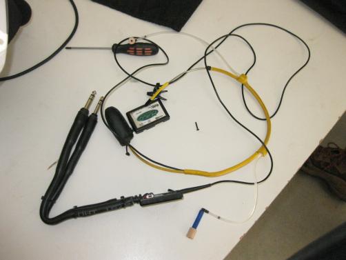

                Ross one of our members over here flies an EA81 engine with a partial low cabin and a windscreen and uses an Icom A20 with a Flycom helmet and interface electronics between the radio and the helmet with great success. It also runs off the gyro battery.
                There are is another member who flies with an American product called a halo headset. This essentially uses tiny hearing aid speakers which transmit their sound into the ears using hollow audio tubes attached to in ear industrial hearing plugs (compressed foam types. He has used the moulded in ear variety and says that the Halo's are superior in clarity and noise exclusion. The downside is that these units are generally on a waiting list of months and cost around $600 aussie dollars delivered. I have been trying to manufacture our own similar design between radio works over here.
                These are extremely lightweight and fit under your standard helmet earcup which precludes most of the external noise.
                This was my first choice for the aforementioned job above but that customer flatly refused to have anything in his ears. Fair enough.
                So another option.
                Regards................Chook.
