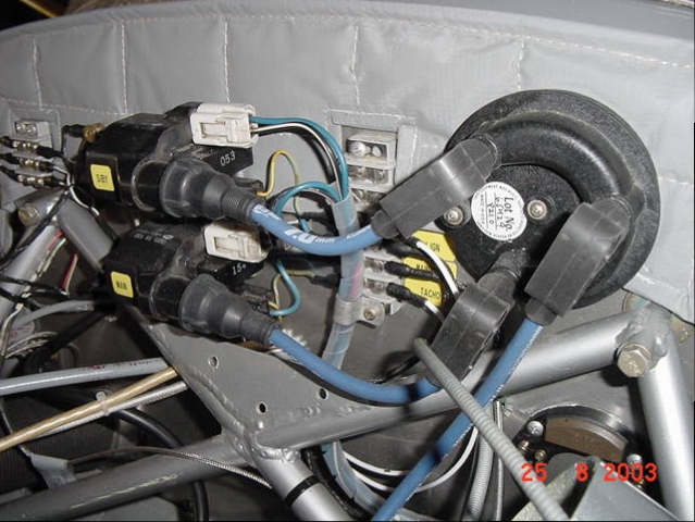

      Over the years I've had one original subaru senser/igniter fail while pre-rotating. (Blamed the low voltage and starter motor reverse current spikes) solved problem by fitting a diode at the elect. pre-rotator. And I've had two sets of points brake springs. Since installing twin electronic ign. into single plugs it started better and never failed. Aircraft now happily lives at Byron Bay.

        I was reviewing my G133 notes and stumbled across this for you -
        Subaru dual electronic ignition notes from Recreational Flying forum.
        Paul if you go to the Yahoo group 'flysoob' in the attachment section there is a full drawing and details of how to made your own base plate to accept 2 trigger modules therefor giving you dual ignition .
        this drives 2 coils that goes to a coil joiner (large diode block) by mallory or msd that has one lead from it to your stock dissy cap.
        I have this set up on my suby ea81 and it works great . the trigger moduals are from local popular cars (pajeros and hyundia i think) and have an after market part number making them available though your local repco,autopro etc.
        The module is P/N BIM076 from repco and the distributor you will need for the reluctor is from a mitsubishi pajero '83 to '93 or mitsubishi nimbus '84 to '92 .
        i swapped out the with points cam assembly with the mitsubishi assemble and just had to make a little spacer or some thing. My suggestion would be to set up your mechanical advance to have 6 deg of movement (distributor that is not crank) . your can do this yourself with a degree wheel or find an auto elect shop that still has a distributor graph and knows how to use it.
        then when back in the engine rev to say 4000rpm and set your timing to 28 deg (absolutely no more ) and this will give you an idle advance of 16 deg which will be smooth and wont kick back on the starter when cranking.
        There has been a lot of experts write all sorts of timing requirements for these motors and I can tell you from my own experience (4 months playing on my own dyno)that they don't make any more power with more than 28deg regardless of compression ratio or camshaft.
        the coil joiners can be bought though performance wholesale, rocket ind or someone like that.
        good luck with all this if you need more info I'm happy to help
        cheers
        Jim

            this is from yahoo FLYSOOB
            https://groups.yahoo.com/neo/groups/FlySoob/files
            attached is a photo and a word document.
            not sure if I can attach the 'How to instruction' sheet, file is a bit big.

              • #22
                see if this works
